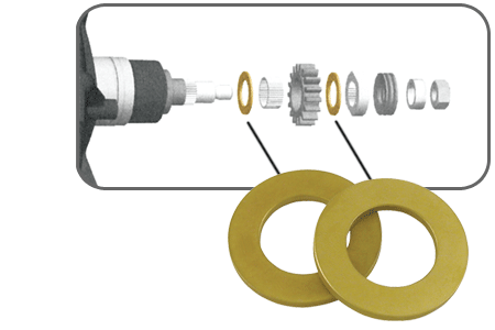

The SC has 2 ceramic washers that are used as a clutch. They are made to slip when the boost level get too high. This would happen at the point when your motor hits the rev limiter as the load is gone when the impeller is out of the water at WOT.
The ceramic washers have had a problem like this in the jetskis for a few years now. In 06 they increased the size of the SC shaft. It seems to have helped some but people are still playing it safe and swapping their fragile ceramic washers out for metal ones.
The ceramic washers desinagrate on failure if they slip too much. These tiny pieces of ceramic material get in the engine through the oiling system. Front and rear oil pumps have to be taken apart and cleaned if the washers fail. $$$
The metal washers don't have this problem. If they start to slip, they can be shimmed and retorqed.

Here's what the clutch looks like on the SC.
The following is a link to a jetski performance site that handles parts, including washers for the 4 tech motors. Jetski and boat share the same motors.
Metal washers

yep thats all the bits they changed on my doo yesterday and got two new guages - so touch wood my doo in now back as good as new - we had a look at the ceramic washers that came out and one was cracked and chipped so it was only a matter of time before it broke up completely -
